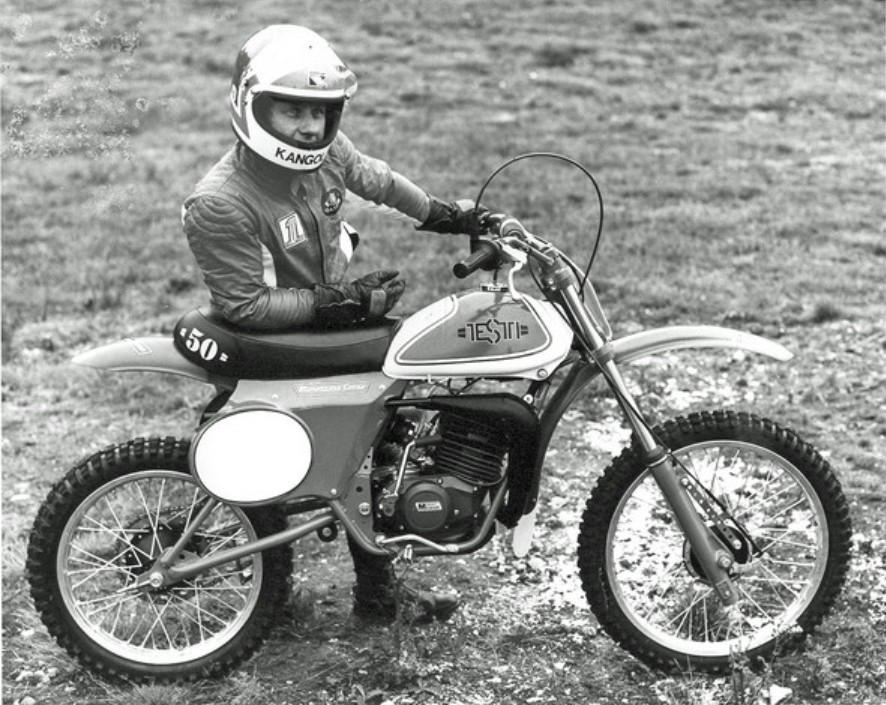

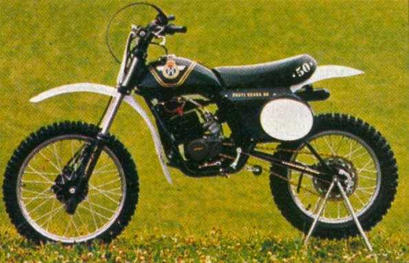

Hello,
I find à testi (gitane elf in France - Horex In deutchland ) To completed.
A lot of parts are missing:
Engine=> i think using minarelli p6 80 from cimatti KC
Wheels=> I think beta mx6 rear and front wheel
Front number plate=> Need information To find one
Exhaust=> Need To find one.
What do you think of thé compatibility parts?
Do you have information or contact To find thé missing parts?
i can exchange With beta mx6 parts:
Seat, weels, tank, air box....

Hi David.
Horex or Testi Cross have the Minarelli P6 50ccm CorsaCorta Engine, not 80ccm
The exhaust look like the Power Exhaust like Aspes
:gu http://www.aspes-navaho.de/phpBB/viewtopic.php?f=21&t=136&sid=b77bf95c03f888c96f9a37e5bbe808ce
So it is possible to get an Power exhaust using a standard exhaust, because the expansion part is the same.
Wheels realy look like Beta Parts.
Frontplate simply build yourself from a PS Plasticpanel
