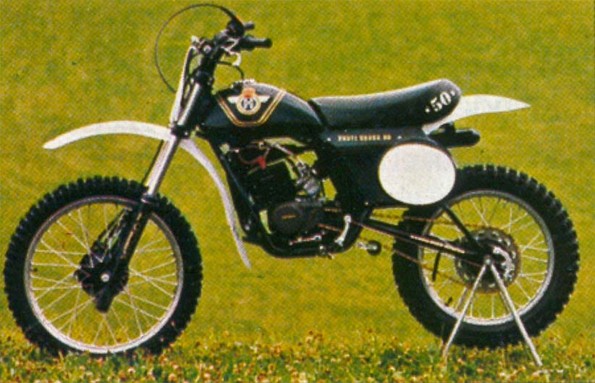

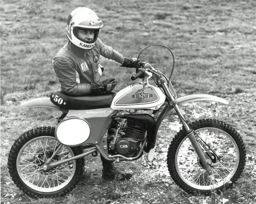

Hello,
I find à testi (gitane elf in France - Horex In deutchland ) To completed.
A lot of parts are missing:
Engine=> i think using minarelli p6 80 from cimatti KC
Wheels=> I think beta mx6 rear and front wheel
Front number plate=> Need information To find one
Exhaust=> Need To find one.
What do you think of thé compatibility parts?
Do you have information or contact To find thé missing parts?

Hi David.
Horex or Testi Cross have the Minarelli P6 50ccm CorsaCorta Engine, not 80ccm
The exhaust look like the Power Exhaust like Aspes
:gu http://www.aspes-navaho.de/phpBB/viewtopic.php?f=21&t=136&sid=b77bf95c03f888c96f9a37e5bbe808ce
So it is possible to get an Power exhaust using a standard exhaust, because the expansion part is the same.
Wheels realy look like Beta Parts.
Frontplate simply build yourself from a PS Plasticpanel
